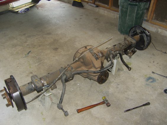

The new 4.10 rear, prepping it to put in.

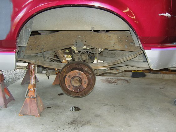

Got the truck in the air and ready to start pulling the 3.55

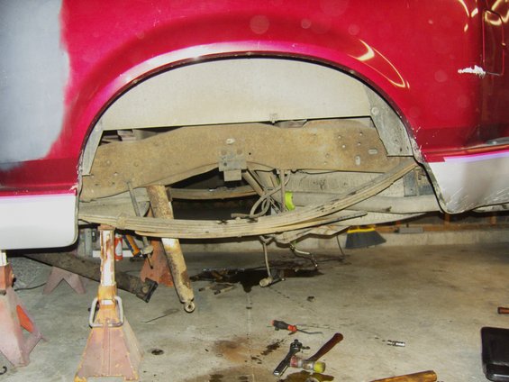

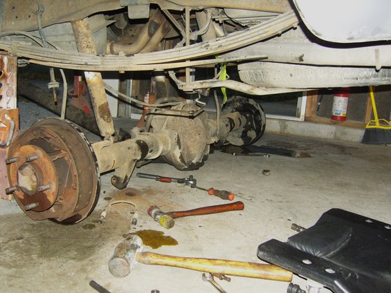

On the floor!
The 3.55 out

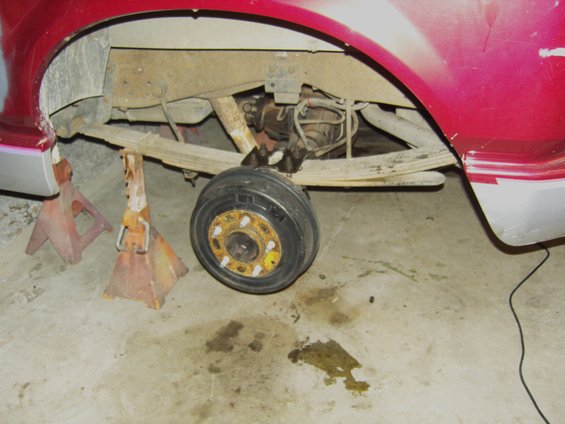

And the 4.10 is in!
