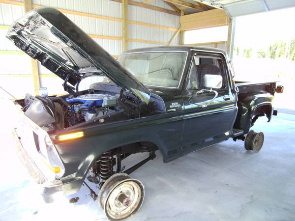

Well, here`s the truck http://www.fordtruckfanatics.com/forum/showthread.php?t=32344&highlight=Neighbors+truck

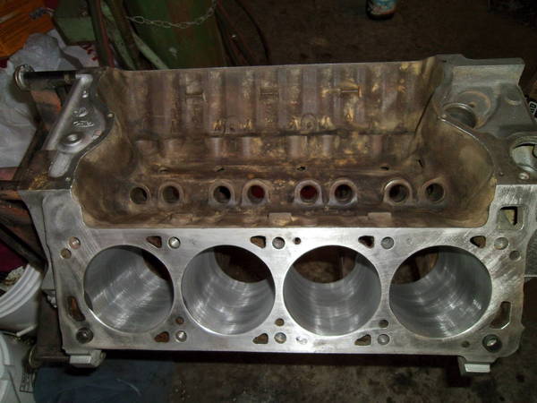

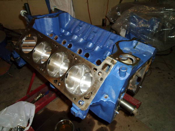

Here`s the engine

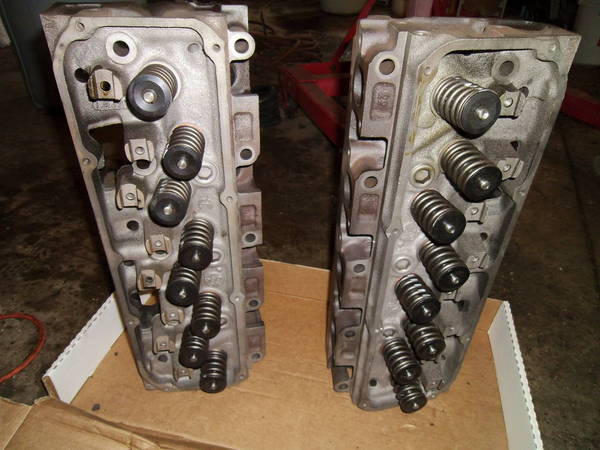

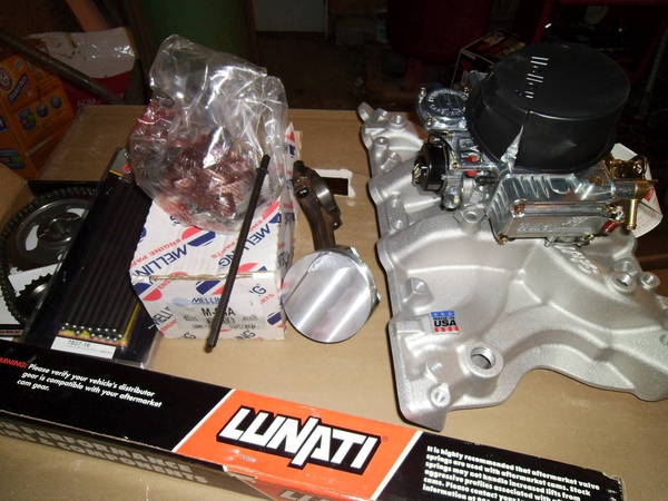

Here`s the parts

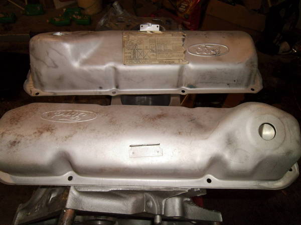

And some stuff I`ve done so far
My oil galley brushes seem to have gone AWOL, so I have to order some more.
It`s .030 over with Tim Meyer pistons, balanced, rods resized with ARP bolts, Lunati Voo Doo cam 213/219 @ .050, .524/.540 lift, and a Performer intake with a 600 Holley. More coming soon.

I`ve been wanting to put a 400 together for a long time. I just have`nt had anything that had one. He put an M in his truck that turned out not to be all it could be. So, he got hold of me, said this is how much I`m looking to spend, play with it some if you want, because I don`t want to be embarrased when someone says let er eat.
I tore the M apart to discover that it was already 30 over with a big ridge, so I offered up this 400 that has been taking up space in my barn since 01. He is pretty much done with his end, so I guess I`d better get busy.

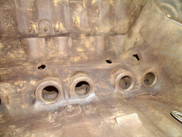

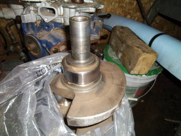

Holy crap! Is this thing done yet? Well, almost. I had to send it back to the machine shop to be line bored. I put the crank in, spun it, and it had a tight spot. Checked a bunch of stuff and line boring was the answer. Now, I`ve always line bored my own engines, and taken flak for it. Everyone has always told me "if the crank turned nice it doesn`t need it." Well, it needed it.
I pretty much screwed the short block together this weekend, and it will be done next weekend, which is when we are dropping it in. I thought I had some in between pics, but I don`t.

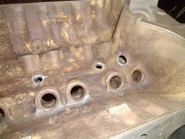

Nice build! Just one question.
That paint in your lifter valley.. Is it a glyptol paint? I'm not a fan of internal paint period, but if you are, it must be glyptol or it will flake off and do damage.
Derek.
Not if it's prepped correctly and applied with some heat applied.. It'll bake it on and NEVER flake..
If you use high heat like 2000* temp paint above applies..

I can see why some people use Glyptol in their engines, though I feel the returns are hardly, if at all noticeable. It has a lower surface tension which allows liquids to be more easily shed from its surface, positively effecting oil drain back. All this you already know, so why Would you use a "normal" paint that does even less in terms of drain back?
Derek.
Not really, if it's applied evenly it'll make a smoother surface, reduces sludge buildup, and oil drain back as well..
I didn't do the inside of my block as it was very very smooth and reman place coated it with something.. Not sure what but it was already done..

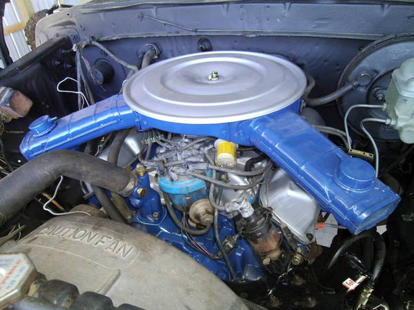

It`s alive!!! Finally! I was in the garage yesterday with the exception of 4 or 5 hours from 8:30 am until 3:00 am, back at it this morning at 9:30, buttoned up, in the truck, broke in, and it`s first oil change all done by about 8:00 pm tonight.
It had 80 psi of oil pressure when I primed it, 60 at 2500 rpm and 200*, and 25 at a hot idle.
I`m a pessimist and I was just just about having kittens the entire time we were breaking in the cam because I thought it was noisier than it should be. Idled it down when it was done and found an exhaust leak.

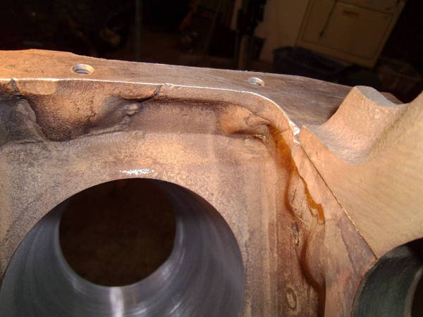

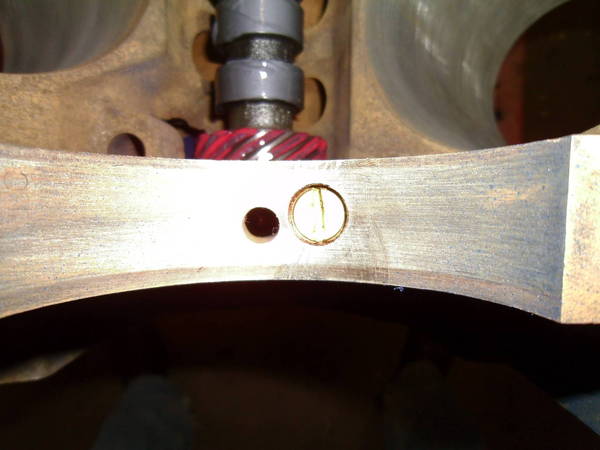

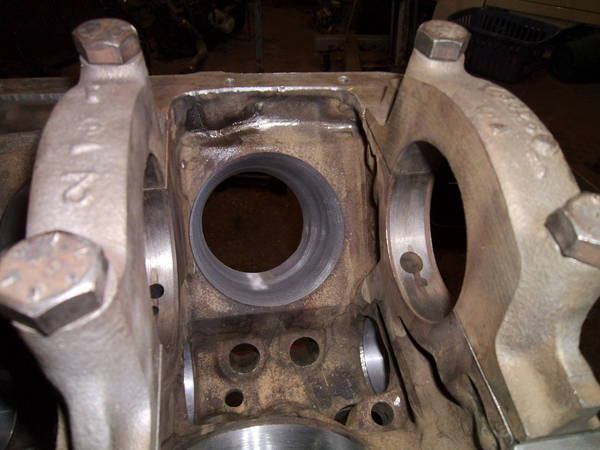

An in progress pic high lighting the oil galley mod on #1 main journal. This was right before it went back to be line bored.:headbang:

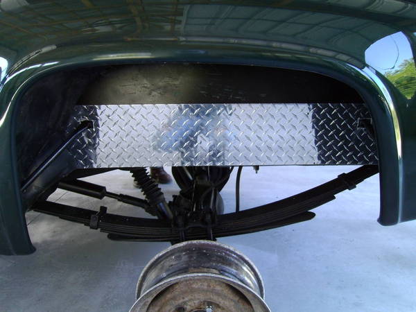

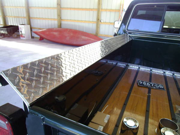

Thanks guys! That coil sure is ugly though. I had fogged it with some paint, but it was wanting to share space with the air cleaner, so I had to move the bracket to bolt it to the head and he was standing there with a digger truck waiting, and we said good enough.
As for the rims, with the lift that was the only way to get it in his garage. He just built the pole barn last fall and poured the cement this spring. All the tools are in the garage, no electric in the barn yet. Besides, he has to put the front fender liners in and cut the diamond plate for the right rear fender braces yet.
