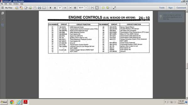

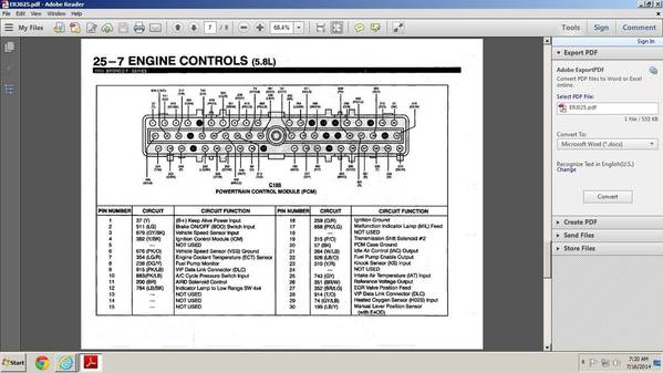

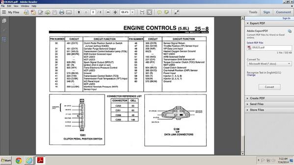

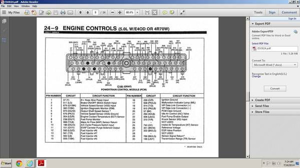

So I want to make sure all my wiring is pretty much identical since I moved to the MAF computer.
I went from a computer that was a 1994 F150 Speed Density 2wd 5.8L E4OD to a 1995 F150 2wd 5.0L E4OD Mass Air Flow.
Do you have access to ECU pin out diagrams so I can make sure all my transmission outputs are identical?
