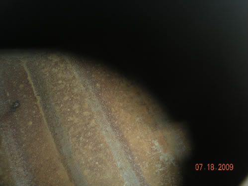

here is a semi picture of what the inside of my tank looks like.
YUM
