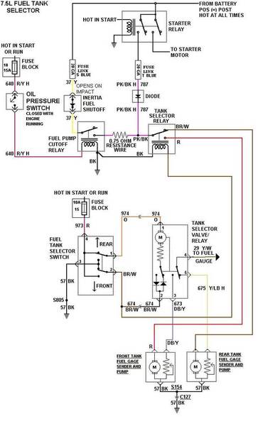

Here is a wiring diagram I made for this system.
http://www.fordtruckfanatics.com/gallery/data/542/medium/1983_Fuel_El_C_T.JPG
If you can not read the diagram email me your email address at the address below and I will email it to you.
